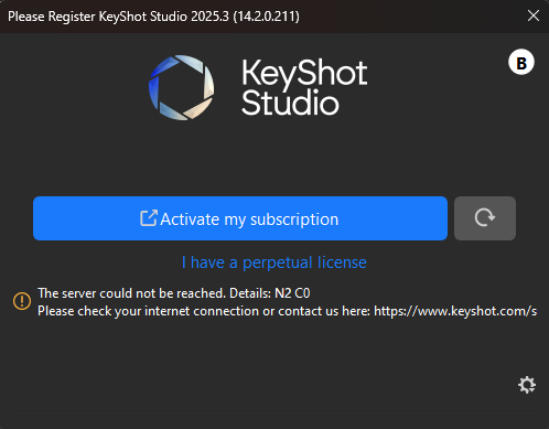

When trying to activate KeyShot, you may get the following error.
The server could not be reached. Details: N2 C0
![](https://support.keyshot.com/hs-fs/hubfs/image-png-Mar-30-2026-01-50-32-1058-PM.png?width=498&height=389&name=image-png-Mar-30-2026-01-50-32-1058-PM.png)
### Environment Details
- KeyShot
### Cause
- The error N2C0 means that the remote server closed the connection prematurely, before the entire reply was received. This usually points towards a connection issue.
  This is most likely due to the Firewall settings.
