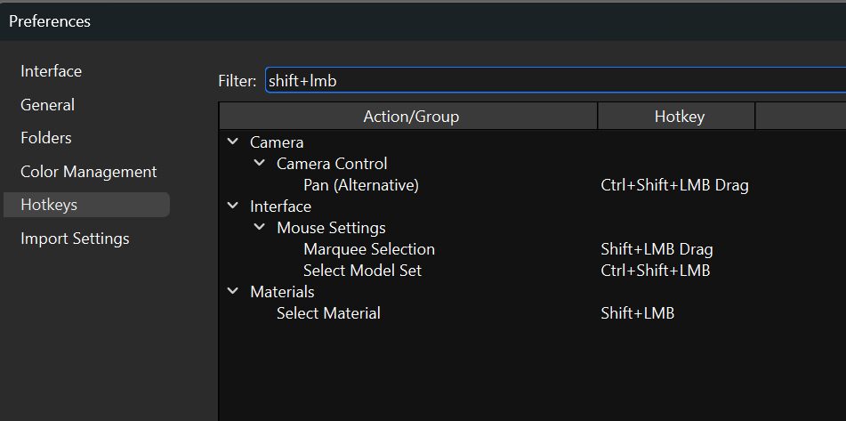

The click handling is extremely sensitive in this part of KeyShot Studio: even if the mouse moves by a single pixel during the press and release of the mouse button, it is not registered as a click but a drag and thus a different hotkey combination.
If this is not the case, this issue might happen if the respective shortcuts are assigned multiple times with overlapping functionality where the other function might take priority.
You can search the Hotkeys in the Preferences by filtering for the hotkeys, e.g.
Shift+LMB
Shift+RMB
![](https://support.keyshot.com/hs-fs/hubfs/image-png-Mar-31-2026-03-55-07-7414-PM.png?width=951&height=473&name=image-png-Mar-31-2026-03-55-07-7414-PM.png)
and check if there are conflicting shortcuts.
If the issue still persists, please check for other software that might be running and might be using the same hotkey combinations and taking priority.
