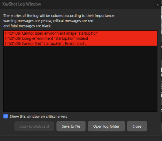

## When launching KeyShot, the error appears stating "The following resources are missing: Startup.hdr"
#### Issue
Upon launching KeyShot, the following errors may appear. KeyShot Resources may also be missing.
![d138addc-eaab-472f-993e-41b6aa10cbce-TICKET.attachments-startup-error.jpg](https://api-na1.hubspot.com/filemanager/api/v2/files/198577940145/signed-url-redirect?portalId=2757257)![](https://support.keyshot.com/hs-fs/hubfs/image-png-Nov-15-2025-12-52-02-0969-AM.png?width=523&height=456&name=image-png-Nov-15-2025-12-52-02-0969-AM.png)
### Environment Details
- KeyShot
    - Any version
### Resolution
Perform a Fresh Install and be sure to keep the Resources folder at it's default location or at the very least a local drive. Be sure that the Resources Folder location is correct in the Preferences settings.
