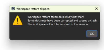

## When trying to launch KeyShot, an error screen shows up for about a second before it disappears and then nothing happens.
### Issue
#### When trying to launch KeyShot, an error screen shows up for about a second before it disappears and then nothing happens. The error shows as follows:
