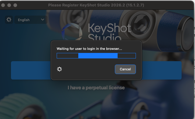

### Issue
KeyShot Studio is stuck at the message, "Waiting for user to login in the browser..." with a loading bar.
![](https://support.keyshot.com/hs-fs/hubfs/Waiting_for_user_error-png.png?width=640&height=389&name=Waiting_for_user_error-png.png)
KeyShot logs can also show the following errors:
\[I\] Permission cache is not present. Will fetch permissions from server.
\[W\] QSqlDatabasePrivate::database: requested database does not belong to the calling thread.

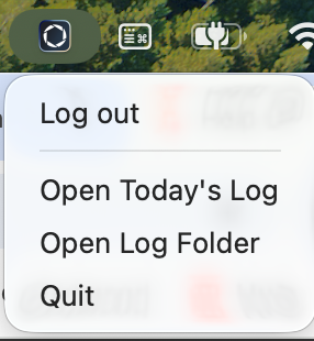

Manually quit KeyShot ID.
1. Go to the top right of the computer screen where you should see a KeyShot icon.
   ![](https://support.keyshot.com/hs-fs/hubfs/log_out-png.png?width=286&height=310&name=log_out-png.png)
2. Click on it to bring up the option to "**Log out**".
3. Close KeyShot Studio and try again.
