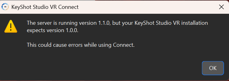

When trying to use KeyVR Connect with KeyVR 2025.1 or older, a warning error occurs:
"The server is running version 1.1.0, but your KeyShot Studio VR installation expects version 1.0.0. This could cause errors while using Connect"
![](https://support.keyshot.com/hs-fs/hubfs/undefined-May-05-2026-05-42-31-3236-PM.png?width=670&height=239&name=undefined-May-05-2026-05-42-31-3236-PM.png)
### Environment Details
- KeyVR
    - 2025.1 and older
### Cause
- We have updated our KeyVR connect server. The server version is different now which will trigger the error.
### Resolution
KeyVR connect will still work fine. To prevent the warning from occurring you can upgrade to KeyVR 2026.1. You can download the latest installer [here](https://account.keyshot.com/download).
