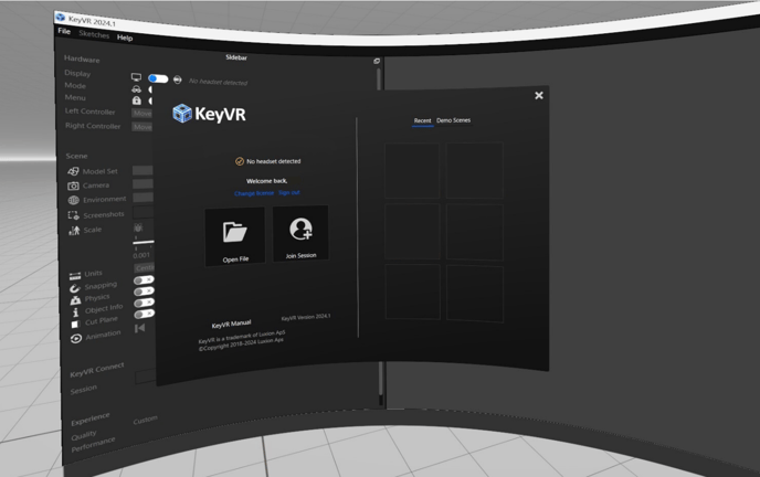

Sometimes it can happen that the Meta Quest2 is not detected after launching KeyVR in the Quest Link environment.
![](https://support.keyshot.com/hs-fs/hubfs/image-png-Jun-16-2025-01-52-40-2189-PM.png?width=688&height=432&name=image-png-Jun-16-2025-01-52-40-2189-PM.png)No headset detected
