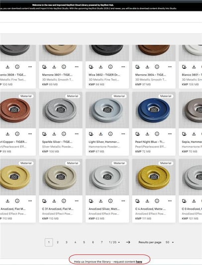

If you notice an asset is missing from the new Cloud Library, you can report it directly to our team using the built-in form.
1. Visit the Cloud Library at [https://cloud-library.keyshot.com/](https://cloud-library.keyshot.com/).
2. Scroll to the very bottom of the page.
3. Click the link to the **Missing Assets Form**.
4. Fill out the form with the details of the missing asset and submit it.
                       ![](https://support.keyshot.com/hs-fs/hubfs/undefined.jpeg?width=406&height=532&name=undefined.jpeg)
Our team will review your request and handle it accordingly.
