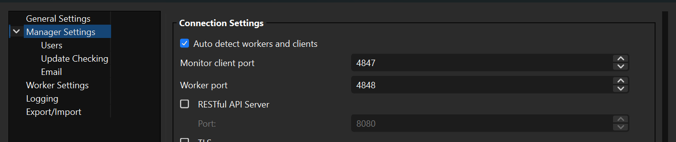

By default the Worker port is 4848, but you can change it in the Network Rendering Configurator in the Manager Settings tab.

To check if the ports are open, please make sure that the Manager is running.
**Windows:**
Open the Start menu or press the Windows key + R. Type powershell in the Run command box. Press Enter. Please enter the following command and replace \<hostname\> with the hostname or IP of the Manager device without the angle‑brackets
Test-NetConnection -Port 4848 -ComputerName \<hostname\>
If the port is open, it should say that the *TcpTestSucceeded: True*.
Otherwise, please open the port on both devices.
If *PingSucceeded: False* is displayed, then the devices cannot reach each other on the network.
**MacOS:**
On MacOS, press ⌘ + Space, type Terminal and press Return. Alternatively you can open the Finder, go to Applications, open the Utilities folder and double‑click Terminal.
nc -vz \<hostname\> 4848
If the port is open, you should see a response like *Connection to \<hostname\> port 4848 \[tcp/\*\] succeeded!*
