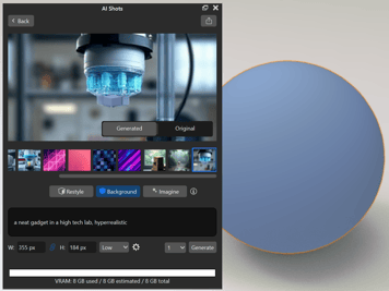

#### **Reusing Saved Image Generations**
**![](https://support.keyshot.com/hs-fs/hubfs/image-png-Oct-30-2025-03-05-26-2366-PM.png?width=670&height=503&name=image-png-Oct-30-2025-03-05-26-2366-PM.png)**
Double-clicking on an already generated image will open it in the larger preview with options.
![](https://support.keyshot.com/hs-fs/hubfs/image-png-Oct-30-2025-04-58-16-9728-PM.png?width=349&height=260&name=image-png-Oct-30-2025-04-58-16-9728-PM.png)![](https://support.keyshot.com/hs-fs/hubfs/image-png-Oct-30-2025-04-58-46-2401-PM.png?width=345&height=260&name=image-png-Oct-30-2025-04-58-46-2401-PM.png)
You will need to double-click it once more in the small preview in order to bring up the option to switch between the generated image and original scene.
You know have the option to reuse the prompt or enter a new one for any of the options, Restyle, Background and Imagine. AI Shots will use the original scene as the input without you having to reopen the corresponding scene.
An image using the old scene will be generated, despite a different scene being currently open.
![](https://support.keyshot.com/hs-fs/hubfs/image-png-Oct-30-2025-05-12-07-2877-PM.png?width=356&height=268&name=image-png-Oct-30-2025-05-12-07-2877-PM.png)
Please note that while you can increase the output resolution, the input resolution will remain the same as the one used for the utilized original generation.

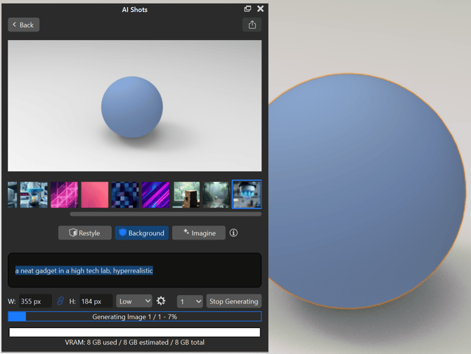

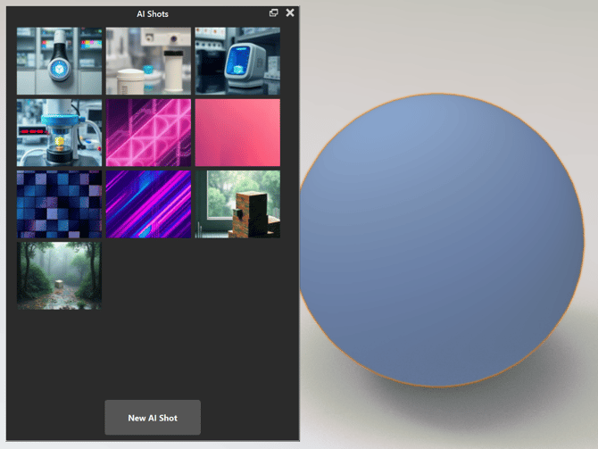

#### **Generating New Images**
In order to generate new images based on the current Scene, you need to click the button "New AI Shot"
If you are in the mode where you already have an image selected, you will need to click the "\< Back" button first in the top left hand corner. If you change the scene, you will have to repeat this process to update the scene that the generations will be based on.
**![](https://support.keyshot.com/hs-fs/hubfs/image-png-Oct-30-2025-05-14-03-6039-PM.png?width=290&height=179&name=image-png-Oct-30-2025-05-14-03-6039-PM.png)![](https://support.keyshot.com/hs-fs/hubfs/image-png-Nov-07-2025-04-26-25-5196-PM.png?width=80&height=45&name=image-png-Nov-07-2025-04-26-25-5196-PM.png)**
Then you will have a preview of the current Scene and can proceed to reuse or enter new prompts.
**![](https://support.keyshot.com/hs-fs/hubfs/image-png-Oct-30-2025-05-13-51-7538-PM.png?width=670&height=505&name=image-png-Oct-30-2025-05-13-51-7538-PM.png)**
