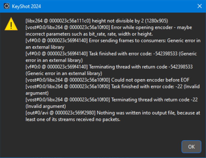

When exporting an animation in KeyShot Studio, users may encounter an error message related to the **render resolution**, specifically:
*"Height not divisible by 2."*
*![](https://support.keyshot.com/hs-fs/hubfs/Screenshot%202025-03-24%20093105-png.png?width=688&height=529&name=Screenshot%202025-03-24%20093105-png.png)*

The error occurs because animation exports require the **height** value to be an **even number**. If the height is set to an **odd number** (e.g., 905 pixels), KeyShot cannot process the export.
### **Resolution**
To fix the issue:
1. **Adjust the Height to an Even Number**
     - Keep the current width as it is.
     - Change the height from an **odd number** (e.g., **905**) to the closest **even number** (e.g., **904** or **906**).
2. **Reattempt the Animation Export**
     - Once the height is corrected, proceed with the export again.
