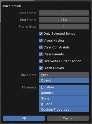

For the animation to be properly, it's best to bake all channels of the action. This also includes baking any possible Constraints as well as Parents.
This means that depending on the setup, instead of just baking all Channels, it might be required to Bake it as a Simulation depending on the software. The example image is from Blender.

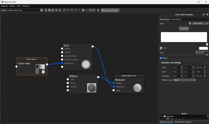

### Fuzz on deformable meshes (for versions 2024.1 and prior)
In versions before 2024.2, the geometry nodes do not update on deformable meshes.
In order to mitigate that, a workaround is to add an animation to the material that is plugged into the geometry node, but does nothing (e.g. changes from a HSV value of 0.1 to 0.1). In the example the Roughness is animated but does not change.
Please note: while it will render the animation correctly, it will not automatically update in the real-time view. You will have to manually click the Refresh Geometry Nodes button.

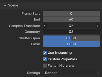

KeyShot calculates the Motion blur, by blurring sub-steps between frames.
Since deformation animations will not have any subframes in KeyShot, the motion blur will not work.
Depending on the software and version, you can set the sub-frame sampling on export.
E.g. in Blender, you can set the number of transformation and geometry samples, which indicate the number of times per frame at which transformations and geometry animations are sampled and written to the Alembic.
![](https://support.keyshot.com/hs-fs/hubfs/image-png-Jan-13-2025-08-19-02-8474-AM.png?width=342&height=260&name=image-png-Jan-13-2025-08-19-02-8474-AM.png)
If a setting like this is not available, there is a workaround which is not ideal and will result in very large files.
It involves creating the sub-steps by stretching the animation.
Stretching it by x32 provides fairly decent results. x16 might be enough.
This means if an animation has a length of 60 frames, it can be stretched by x32 to 1920 frames before exporting. Once imported, the duration needs to be scaled back to be 60 frames. With that method KeyShot will have 30 sub-steps to work with.

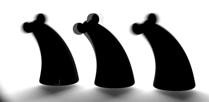

In the image below, the original 60 frames animation is in the middle with very visible steps.
On the right, the animation was stretched x5 to 300 frames and the individual steps are still very visible.
On the left it's the same animation stretched x32 to 1920 frames and provides a decent result.
![](https://support.keyshot.com/hs-fs/hubfs/image-png-Jul-12-2024-12-30-41-5258-PM.png?width=688&height=336&name=image-png-Jul-12-2024-12-30-41-5258-PM.png)
