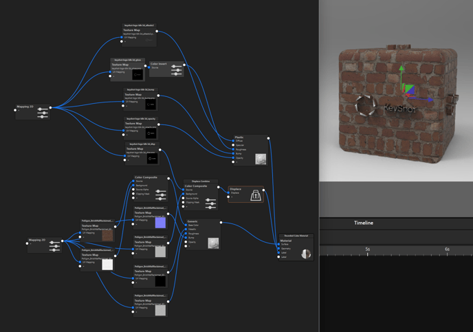

Using the script, it is possible to have textures automatically assigned to the shader and also use it to assign textures to labels. The material below is created using the script.

Before running the script, you need to drag a set of textures into the Material Graph of a Material.
The script will create additional nodes if required, for example
  • A Color Composite Node for combining Ambient Occlusion with the Diffuse Color.
  • Connecting the Displacement texture with the Geometry input.
  • An Invert Node for converting a Glossiness texture to Roughness
  • Another Color Composite Node for combining a Label displacement with a displacement that is already present.

After the script finishes, you can align the nodes by pressing the Align Nodes button on top of the Material Graph.
