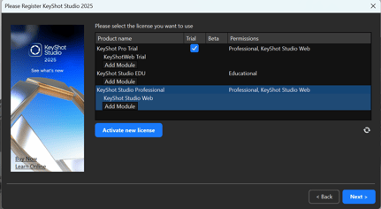

1. Select 'Activate my license'.
2. Select 'I have a subscription'.
3. Sign in to your KeyShot Cloud account.
4. You should see a screen like this:
5. At this point, simply select 'Next' and then 'Finish' (Do not select 'Activate new license').
