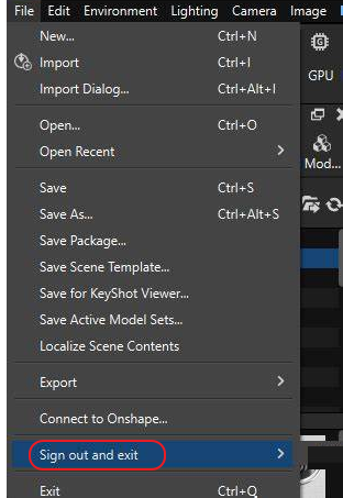

Clear cache in KeyShot Studio.
1. In KeyShot, go to File \> Sign out and exit. (**This is important to disconnect any "remembered" users.**)
   ![](https://support.keyshot.com/hs-fs/hubfs/image-png-Jan-31-2025-06-31-14-9960-PM.png?width=312&height=453&name=image-png-Jan-31-2025-06-31-14-9960-PM.png)
2. Delete the **KS12Settings.xml** file to clear any cached data.
