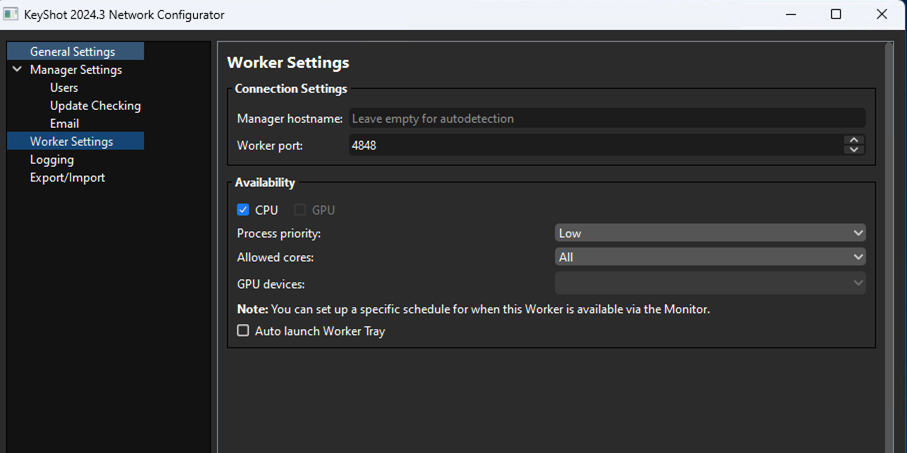

Issue
When launching the KeyShot Network Configurator, the GPU option in Worker Settings appears grayed out and cannot be selected.

Cause
  • Outdated GPU Drivers: KeyShot requires the latest GPU drivers for optimal compatibility and performance.
  • Incompatible GPU: The installed GPU may not meet KeyShot’s compatibility requirements. Refer to our list of compatible GPUs.
Resolution
  1. Update Your GPU Drivers:
    • Ensure your GPU drivers are up to date. Check your GPU manufacturer's website for the latest updates (e.g., NVIDIA or AMD).
  2. Verify GPU Compatibility:
  3. Contact Support:
    • If your drivers are updated and your GPU is listed as compatible but the issue persists, please reach out to KeyShot Technical Support for further assistance.
