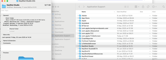

Mac Default:
  • Library/Application Support/KeyShot Studio
*NOTE: There are two library folders on the Mac. One is a hidden folder and the other isn't.
For older versions, replace Studio with the version number, e.g. KeyShot 12 for KeyShot 2023, KeyShot 11, etc.
 The Library Folder you want is the one you can access directly from your Macintosh HD (see below)
If you can go direct to your Macintosh HD, then you should be able to see the Library folder in there.

macOS: Setting Resource folder permissions
  1. In Finder, browse to Macintosh HD > Library > Application Support.
  2. Right-click the KeyShot folder and select “Get Info”.
  3. Scroll to Sharing & Permissions and ensure all users listed have Read & Write access.
  4. If your username isn’t listed, click the + to add it and give Read & Write.
  5. Click the settings (gear) icon, choose “Apply to enclosed items”, and confirm.
  6. Close the Get Info window.
