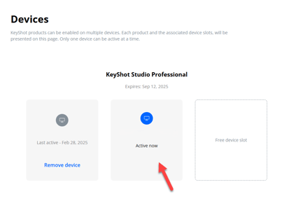

You may be unable to remove a device from your KeyShot account if it is currently activated and signed in with KeyShot. Devices that remain signed in cannot be removed from the Manage Devices section of https://account.keyshot.com/devices.

After signing out, log into your KeyShot account.
Navigate to the Manage Devices section.
You should now see the option to remove the device.
