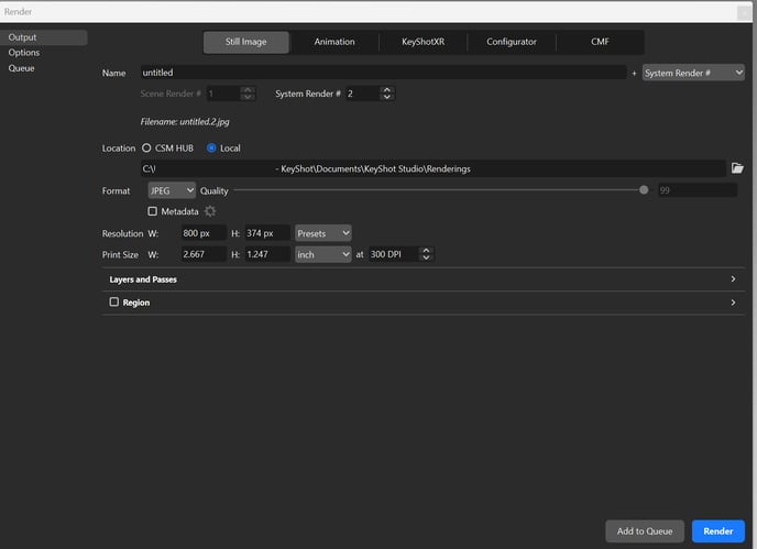

1. Enter the desired DPI and click Render:

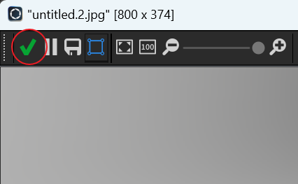

2. When the render screen shows up, select the green check mark rather than the save button. This will save the file at the correct DPI.
