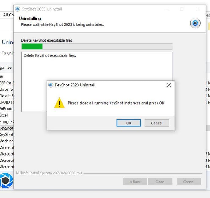

If you receive an error message stating that multiple instances of KeyShot are running when trying to uninstall KeyShot Studio, follow the steps below to resolve the issue.

This error occurs because one or more KeyShot Studio processes are still active. These may include:
  • Open KeyShot Studio application windows.
  • Background KeyShot Studio processes (e.g., KeyShot Network Rendering)
Resolution
  1. Close All KeyShot Studio Processes:
    • Check if any KeyShot Studio application windows are open and close them.
    • Open the Task Manager (Ctrl + Shift + Esc on Windows) or Activity Monitor (on macOS). Look for any processes named "KeyShot" or "KeyShot Network Rendering" and end those tasks if they are running.
  2. Retry Uninstallation:
    • Once all processes are closed, return to the uninstallation prompt and click OK to proceed.
  3. Restart Your Computer (if needed):
    • If the issue persists, restart your computer to ensure no KeyShot-related background processes are running. Then attempt the uninstallation process again.
