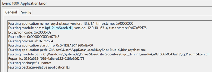

Look through the search results if there is an Application Crashing Event.
![](https://support.keyshot.com/hs-fs/hubfs/image-png-Jun-19-2025-03-58-42-3708-PM.png?width=1891&height=47&name=image-png-Jun-19-2025-03-58-42-3708-PM.png)
If the faulting module name is igd12um64xeh.dll, the crash is caused by the Intel GPU driver
![](https://support.keyshot.com/hs-fs/hubfs/image-png-Jun-19-2025-03-55-50-1934-PM.png?width=688&height=234&name=image-png-Jun-19-2025-03-55-50-1934-PM.png)

- This is a general Intel GPU driver issue with integrated or dedicated graphics on intel processors that affects several applications, not just for KeyShot Studio. Many applications experience similar crashes on start-up with the exact same symptoms.
