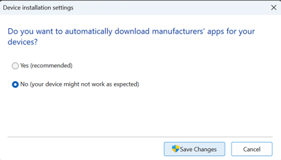

You could try disabling it in the Device Installation Settings, though this disables driver updates for all devices.
1. Open **Control Panel** \> **System** \> **Advanced system settings**.
2. Go to the **Hardware** tab.
3. Click **Device Installation Settings**.
4. Select **“No (your device might not work as expected)”**.
5. Save and restart.
 ![](https://support.keyshot.com/hs-fs/hubfs/image-png-Sep-12-2025-03-57-42-2696-PM.png?width=409&height=233&name=image-png-Sep-12-2025-03-57-42-2696-PM.png)
