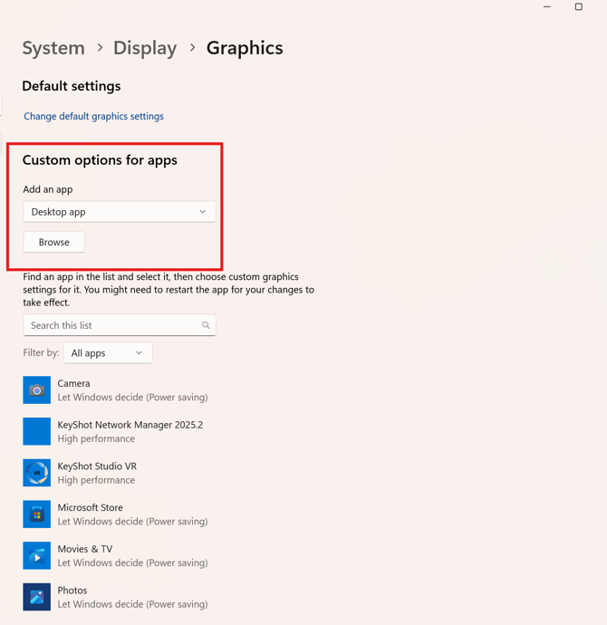

2. Under display settings, scroll down and click Graphics.

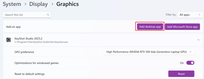

3. From here you can add KeyShot (if not added already) depending on your Windows 11 version. You may see the option to 'Add desktop app' or you may have the option preset and only need to click 'browse'
4. Click on the Browse button and select the following depending on how KeyShot was installed

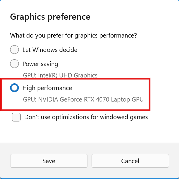

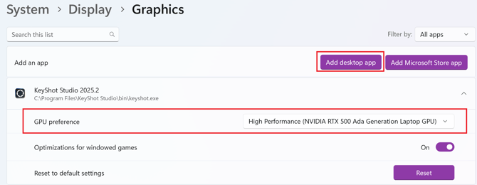

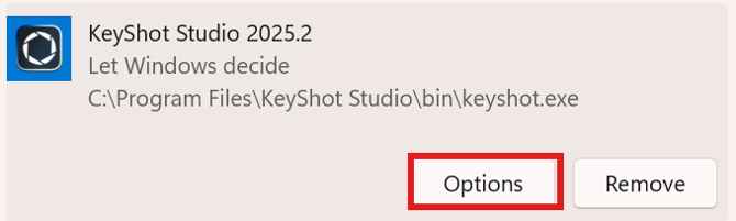

5. Click on the Options button and select "High Performance" from the Graphics specifications drop-down menu OR you may have the GPU preference dropdown menu option depending on your Windows version
   **Windows 11 Pro:**![](https://support.keyshot.com/hs-fs/hubfs/image-png-Aug-14-2025-06-18-39-1399-PM.png?width=670&height=261&name=image-png-Aug-14-2025-06-18-39-1399-PM.png)
