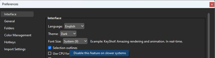

### Disable Outlines
In the Interface tab of the Preferences, you can disable the selection outlines, as the outlines on big and complex assemblies can be very taxing on the system.![](https://support.keyshot.com/hs-fs/hubfs/image-png-Apr-04-2025-08-38-48-9332-AM.png?width=818&height=224&name=image-png-Apr-04-2025-08-38-48-9332-AM.png)

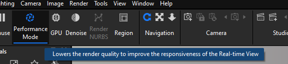

At the cost of a lower rendering quality, the responsiveness of the Real-time rendering can be improved by toggling the Performance Mode by clicking on it in the Ribbon or through the hotkey Alt+P.
This setting will not affect the rendering output settings, so it's a quick way to increase the performance while editing the scene.

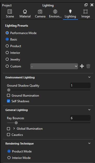

In the Project ➝ Lighting settings you can also set lower options for the Shadow Quality, Samples and other settings in order to make the lighting less demanding. Please note that this will affect the render results but will also provide a closer representation of the full quality render result than the Performance Mode.
You can save different presets to to jump between for editing and the final rendering.

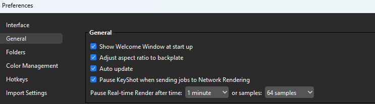

### Set the Real-time Rendering to pause
In the General tab of the Preferences, you can additionally set the real time rendering to pause after a certain time or after reaching certain number of samples.
Without that setting and if not paused, KeyShot will keep evaluating samples indefinitely even in the background and use up resources.![](https://support.keyshot.com/hs-fs/hubfs/image-png-Apr-04-2025-08-33-59-7493-AM.png?width=743&height=207&name=image-png-Apr-04-2025-08-33-59-7493-AM.png)
You may want to disable it for evaluating the required amount of samples for a final rendering, but outside of that scenario it's best to have it enabled.
