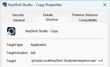

You can also edit the shortcut or a copy of the shortcut and add
-v 4to the end of the Target.
