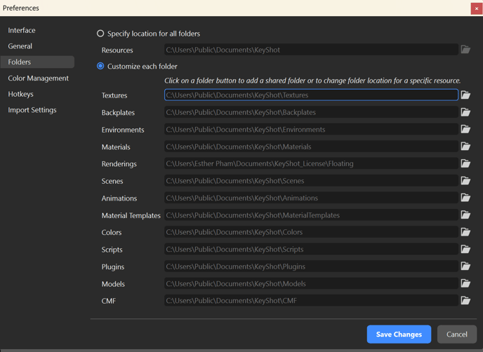

- Go to the Edit drop down menu and select Preferences
- Select Folders on the left side panel in the pop-up box that appears
- Select Customize each Folder if you would like to specify each folder
- Go to Resource you want to add to. Click on the Folder Icon. The Configure Folders window will pop up
- Click Add. (plus sign) The Add folder window will pop up
- Click the Folder Icon, browse to the desired sub-folder for the relevant resources and click Open
- Click Ok twice. Then, click Save Changes
- You will now be able to find your sub-folders inside the KeyShot Library window.
