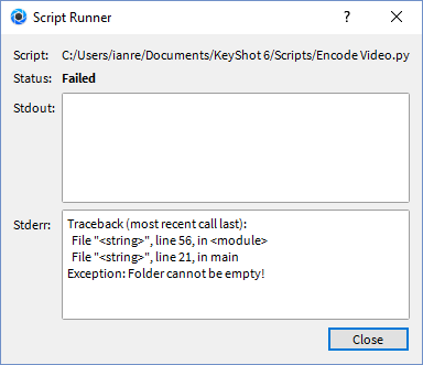

**Section 2:** Check for errors and exit peacefully if errors arise. Assign user input to corresponding variables. A line-by-line code breakdown is shown below.
- If the user clicks "Cancel", exit gracefully.
- If the frames folder is empty, give an error message.
- Assign the folder path to the fld variable.
- Assign the files format to the files variable.
- If the file format is empty, give an error message.
- If the file number isn't there give error message.
- Compile the frame numbers into a pattern object called reDigits.
- Make a boolean expression called found and set it to "False".
- From line 35 to line 41 check that the frames with the correct format are present. If not, stop the script.
- Assign the starting frame to the start variable.
- Assign the ending frame to the end variable.
- If start is greater than end, give an error message.
- Assign the desired frames per second to fps variable.
- If the name desired is empty, give error message.
- Assign the desired name to the name variable.
