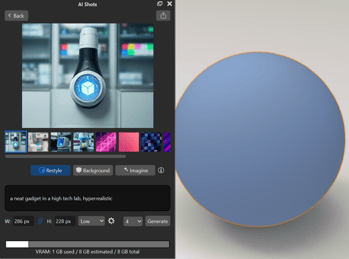

The generated images will now persist and there is option to use older prompts in new scenes.
A VRAM bar has been added to show how much of the system's capacity is being utilized.

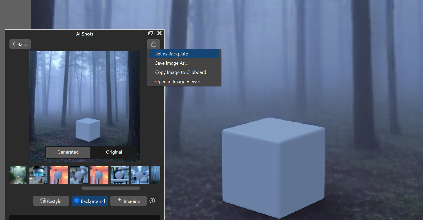

It is now also possible to directly set the generated background or other generated images as a backplate.

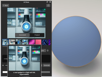

Double-clicking on an already generated image will open it in the larger preview with options.
You will need to double-click it once more in the small preview in order to bring up the option to switch between the generated image and original scene.
You know have the option to reuse the prompt or enter a new one for any of the options, Restyle, Background and Imagine. AI Shots will use the original scene as the input without you having to reopen the corresponding scene.
An image using the old scene will be generated, despite a different scene being currently open.
Please note that while you can increase the output resolution, the input resolution will remain the same as the one used for the utilized original generation.
