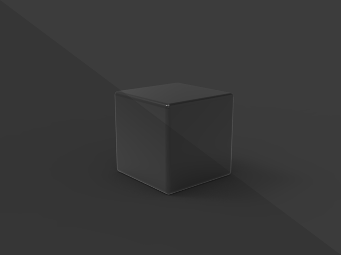

**Why does my render look darker or lighter when saved as an EXR file?**
`EXR` files store linear color data without gamma correction, which makes them appear darker than `PNG` or **Real-time View** outputs that apply `sRGB` gamma correction (typically `2.2` gamma). To ensure consistent results with the `EXR` format, apply a gamma correction of `2.2` when converting or displaying the image.
Other formats like `PNG` files and the **Real-time View** apply `sRGB` gamma correction (typically `2.2` gamma), making them appear brighter and more consistent with what is displayed on a standard monitor.

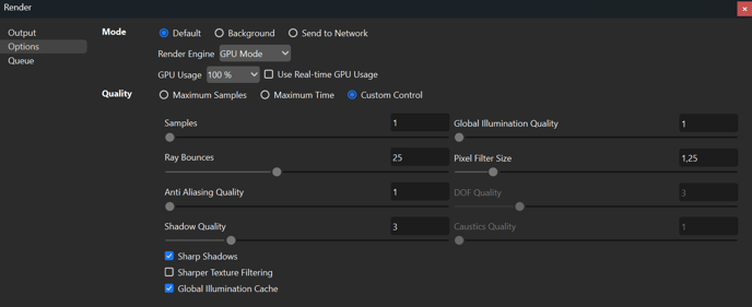

**Why does my render look different when using Custom Controls or a different render engine?**
![](https://support.keyshot.com/hs-fs/hubfs/image-png-Jun-18-2025-02-39-25-5490-PM.png?width=670&height=275&name=image-png-Jun-18-2025-02-39-25-5490-PM.png)
When using **Custom Controls**, a different algorithm and lighting settings are applied, which results in a different render output.
Selecting a different **Render Engine** than the one used in the **Real-time View** may also produce slight visual differences, since there is currently no complete parity between `CPU` and `GPU` materials.
