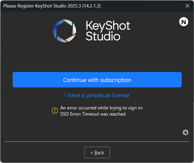

When trying to activate KeyShot Studio, you may get an SSO Error: Timeout was reached

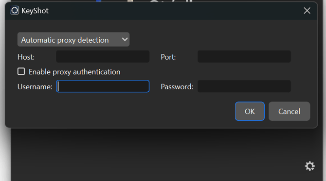

If you are using a proxy, you can click the gear icon in order to open the proxy settings dialogue for setting the proxy information and selecting a protocol

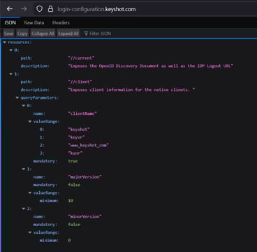

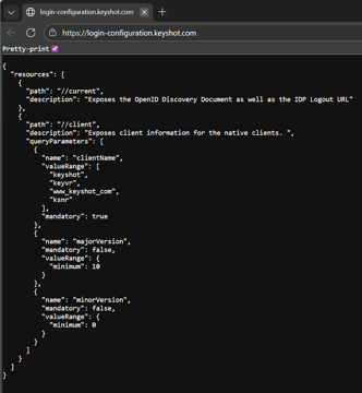

Please try to enter the URL [https://login-configuration.keyshot.com](https://login-configuration.keyshot.com) into your browser.
###### 3.1. Browser shows the json
Depending on the browser and the configured formatting, the result should be a json that looks similar to the screenshots below
![](https://support.keyshot.com/hs-fs/hubfs/image-png-Dec-09-2025-11-10-15-6502-AM.png?width=368&height=360&name=image-png-Dec-09-2025-11-10-15-6502-AM.png)![](https://support.keyshot.com/hs-fs/hubfs/image-png-Dec-09-2025-11-13-47-9745-AM.png?width=332&height=360&name=image-png-Dec-09-2025-11-13-47-9745-AM.png)![](https://support.keyshot.com/hs-fs/hubfs/image-png-Dec-09-2025-11-10-38-0978-AM.png?width=670&height=97&name=image-png-Dec-09-2025-11-10-38-0978-AM.png)
If the URL [https://login-configuration.keyshot.com](https://login-configuration.keyshot.com/) works in the browser but KeyShot Studio still times out, the issue is almost certainly local (firewall rule for the app, proxy handling, or SSL inspection).
