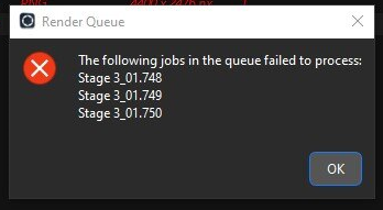

The error "The following jobs in the queue failed to process:" occurs when trying to send jobs to the Rendering Queue
Issue
When sending jobs to the render queue, there is an error that pops up that is similar to the one seen below:

Updating your GPU driver to the latest driver seems to resolve this issue. Click here to use the Nvidia search tool to find the latest drivers.
