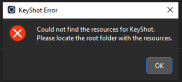

When launching KeyShot, there is an error saying that the Resources cannot be found. Installing license files or activating a subscription will also fail.
Could not find the Resources for KeyShot. Please locate the root folder with the resources.
![](https://support.keyshot.com/hs-fs/hubfs/image-png-Nov-14-2024-04-27-58-8834-PM.png?width=368&height=166&name=image-png-Nov-14-2024-04-27-58-8834-PM.png)

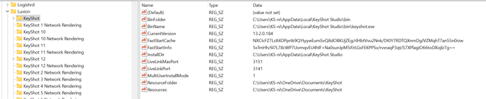

Please confirm if  after opening the Registry Editor and browsing to either
- Computer\\HKEY\_CURRENT\_USER\\SOFTWARE\\Luxion\\KeyShot        (if installed "just for me")
or
- Computer\\HKEY\_LOCAL\_MACHINE\\SOFTWARE\\Luxion\\KeyShot     (if installed "for everyone")
looks similar to the screenshot below
The bottom two values "Resources" and "ResourceFolder" in the key "KeyShot" should have the same data
If they are different or missing, please make sure that the data for the value "ResourceFolder" is the same as in "Resources" or continue below.
![](https://support.keyshot.com/hs-fs/hubfs/image-png-Nov-21-2024-01-15-02-1327-PM.png?width=670&height=138&name=image-png-Nov-21-2024-01-15-02-1327-PM.png)

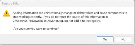

Once all paths are adjusted, save that text as KeyShot.reg and double click it.
Windows will ask if you want to allow this app to make changes to the registry. Please allow it and confirm. KeyShot should now be able to locate the Resource Folder and install licenses and activate subscriptions.
