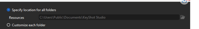

or the Resources cannot be reassigned or saved with the Folder being greyed out in the Preferences

The bottom two values "Resources" and "ResourceFolder" in the key "KeyShot" should have the same data
If they are different or missing, please follow the instructions in this article first: Could not find the Resources for KeyShot. Please locate the root folder with the resources.

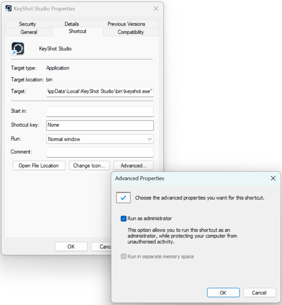

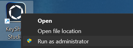

As a workaround, please run KeyShot as administrator, by right-clicking the shortcut and selecting "Run as administrator"
You may edit the shortcut to run KeyShot as administrator by default by right-clicking the shortcut and opening to the Properties. In the Shortcut Tab on the bottom right, click on "Advanced..." and click the checkbox "Run as administrator" and confirm.
Opening KeyShot trough that shortcut should then automatically run is as administrator and grant it the necessary permissions.
