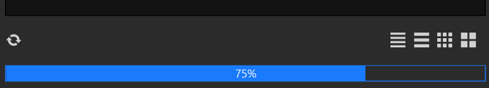

You may find that your Library is not loading completely or at all or that folders are invalid.

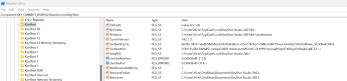

This can only be changed through the registry.
- if installed Just For Me:
Computer\HKEY_CURRENT_USER\Software\Luxion\KeyShot - if installed For Everybody:
Computer\HKEY_LOCAL_MACHINE\SOFTWARE\Luxion\KeyShot
The last two values are the ResourceFolder and Resources.
The Resources are the resources like Textures, Scenes, Materials, etc.
The ResourceFolder on the other hand are the Settings and will by default be in the default installation location.
If that is not writable, you can move the files to a different folder and adjust the ResourceFolder value accordingly.
