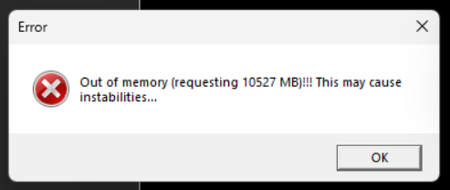

When trying to render you may receive the following error:
Out of memory (requesting 4294967214 MB!!) This may cause instabilities...
![](https://support.keyshot.com/hs-fs/hubfs/image-png-Jun-20-2025-01-37-13-3946-PM.png?width=493&height=208&name=image-png-Jun-20-2025-01-37-13-3946-PM.png)
### Environment Details
- KeyShot
    - Any versions
### Cause
- Out of memory on the system for GPU memory
- Too much geometry created with Geometry Nodes
- Corrupted OptiX cache
### Workarond
Please try the following solutions depending on your situation
#### Solution 1
Try exporting the file type as a "PSD" file instead of a "PNG" file and see if that renders without errors.
If this does not help, it might be caused by Geometry Nodes.

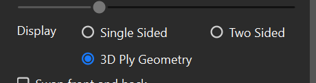

Some materials like the RealCloth when using the 3D Ply Geometry may also cause a tremendous amount of Curves being generated, depending on the object size and weave scale.
Switching to the Single Sided or Two Sided display mode should resolve the issue.
