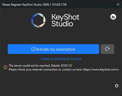

The server could not be reached. Details: N103 C0
Troubleshooting for the error N103 C0
Issue
When activating KeyShot Studio using a proxy, the error N103 C0 may occur
Cause
The N103 C0 error may occur if the hostname cannot be resolved by KeyShot ID.

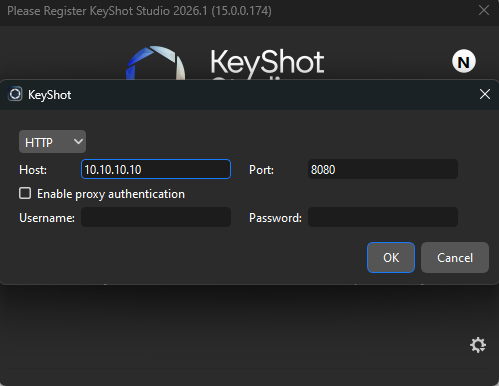

Resolution
Instead of the hostname, please enter the IP address in the place of the hostname in the proxy configuration.
