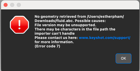

When trying to import a CAD file into KeyShot, you get the error below:
No geometry retrieved from... Possible causes: File version may be unsupported. You may need to export polygonal data from your modeling system.

  • The version of your CAD software is incompatible with the version of KeyShot you are using.
Resolution
Depending on the version of KeyShot and CAD software you are using, you may need to upgrade your KeyShot. If it is available, you can also try using the KeyShot plugin for the CAD software if it is available. Our plugins are available for no additional cost (except for the NX plugin). You can find more information about our plugins here.
You can contact support to see if the CAD software version you are using is compatible with the KeyShot version you are using or if you have any questions.
