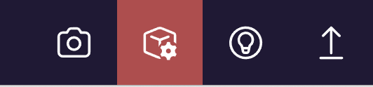

  3. Go to the bottom right of the page and select the 'Inspector" icon
  4. In the Inspector panel, select the 'Tools' tab (the wrench icon)
