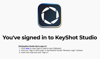

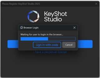

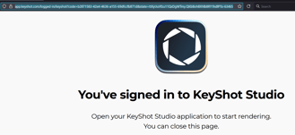

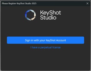

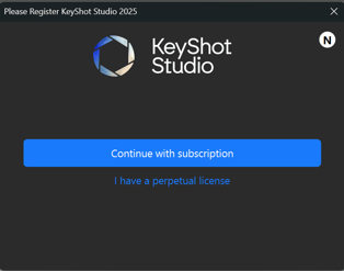

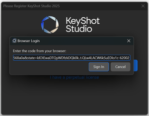

When you activate KeyShot, you should see either this dialogue

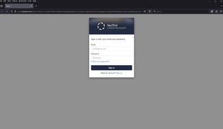

After clicking Sign in with your KeyShot Account, it should open the browser and ask you to sign in.

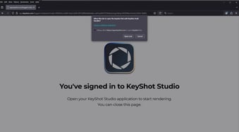

After signing in or when clicking Continue with subscription, the auth handler pop up should appear. Clicking Open Link should get the license activated.
Auth-Handler does not appear
If the auth-handler does not appear, you can use the URL from the address bar as the code, so it would look similar to this:
https://app.keyshot.com/logged-in/keyshot?code=99581bca-b00f-4ceb-b3f0-0f51fdffbbaf&state=dzFhpi6M7ZDSNeuEzmgYx8Ag14P0EfWp1Aimd2.E5bX-56682
(except the code that will come after "?code=9" will be different)
In order to activate KeyShot Studio manually and bypass the authentication handler, you can use a code by clicking "here" in the browser or if that message does not appear, you can copy the URL address and paste it as the code
Please note that waiting more than three minutes may cause the token to expire, making the link unusable and triggering an error.
In that case, please retry and enter the code or URL without much delay.
If it still fails, please delete the tokens as specified in Issue 2

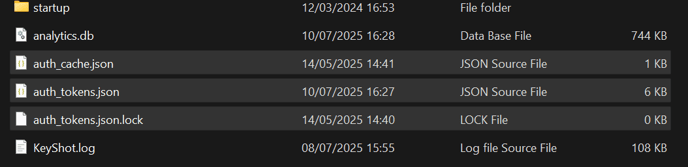

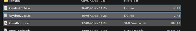

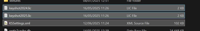

  • In the Resource Folder, delete any old .lic files and the KSSettings.xml
    Please note that if a custom Resource Folder was chosen during installation, these files would still be in the default Resource Folder install location.
    Windows:
    • Installed Just For Me:
      %UserProfile%\Documents/KeyShot Studio or
      C:\Users\<username>\Documents\KeyShot Studio
    • Installed For Everybody:
      C:\Users\Public\Documents\KeyShot Studio or
      %Public%\Documents\KeyShot Studio
    macOS:
    • /Library/Application Support/KeyShot Studio

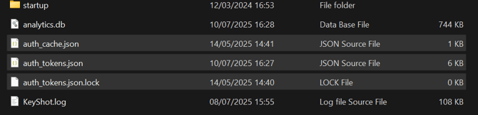

  • In the Appdata, delete auth_cache.json, auth_tokens.json, auth_tokens.json.lock

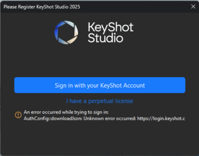

  • The server could not be reached. Details: N3 C0
  • AuthConfig::downloadJson: Unknown error occurred: https://loging.keyshot.com

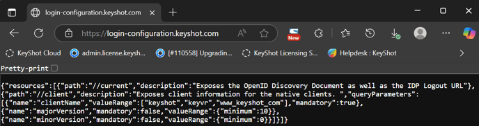

If there are DNS issues mentioned in the logs, you can try flushing the DNS:
You can double-check by entering
nslookup login-configuration.keyshot.com
in the Command Prompt on Windows or Terminal on macOS.
It should look similar to these response

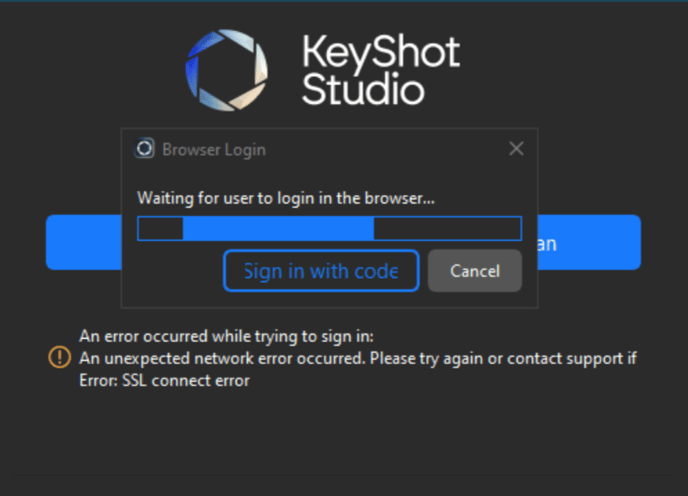

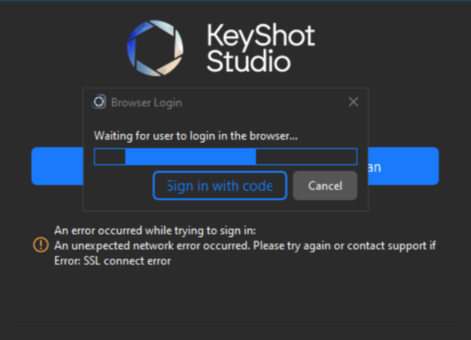

Issue 4: SSL Error and TLS
There may an SSL error, with the browser login window being show too briefly to click anything. This is due to a connection issue that needs to be resolved before a code can be entered.
Cause
The most likely cause for an SSL issue could be
  • the system time being out of sync
  • a proxy
Resolution

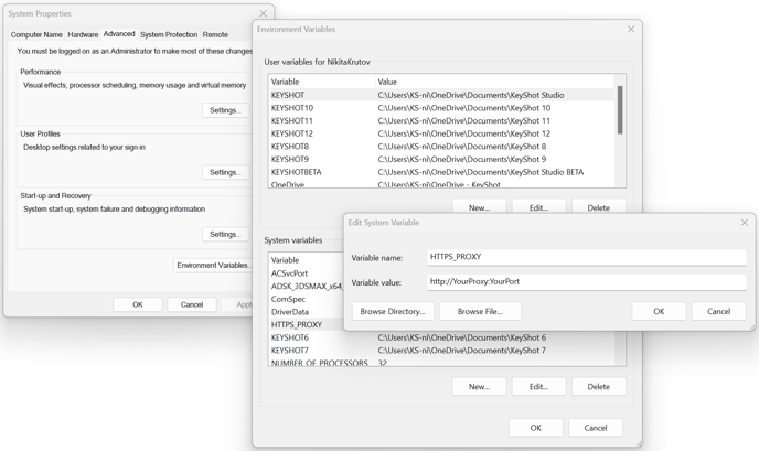

For the proxy, please set up an Environment Variable.
  1. Right-click This PC or Computer on your desktop or in File Explorer.
  2. Choose Properties → then click Advanced system settings on the left.
  3. In the System Properties window, go to the Advanced tab.
  4. Click the Environment Variables… button near the bottom.
  5. In the Environment Variables window:
    • Decide if you want to set it for just your user (User variables) or for all users (System variables).
    • Click New… in the appropriate section.
  6. Fill in the fields:
    • Variable name:  HTTPS_PROXY
    • Variable value: e.g., http://yourproxy:yourport
    Replace YourProxy and YourPort with your proxy details, e.g. http://127.0.0.1:8000
  7. Restart KeyShot

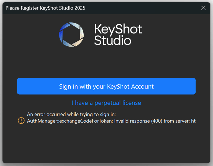

Issue 5: This URL was not generated from this program

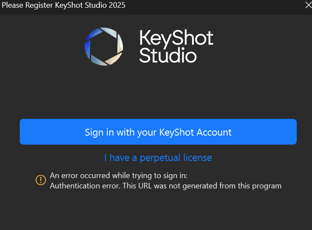

After entering a code, you may see the error "This URL was not generated from this program"
Cause
This error occurs when the pasted code has been edited, or not selected completely when copying or if a previous code for a prior activation is used.
Resolution
Each code is generated uniquely, so please make sure to copy the current code in its entirety.
